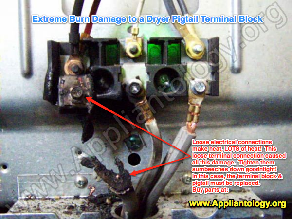

Extreme Burn Damage To A Dryer Pigtail Terminal Block

This is easily avoided by ensuring your power cord connections at the terminal block are goodntight! Buy your replacement power cord and terminal block here ==> http://www.repairclinic.com/Shop-For-Parts?s=t-dryer%20power%20cord-%3d%3d
