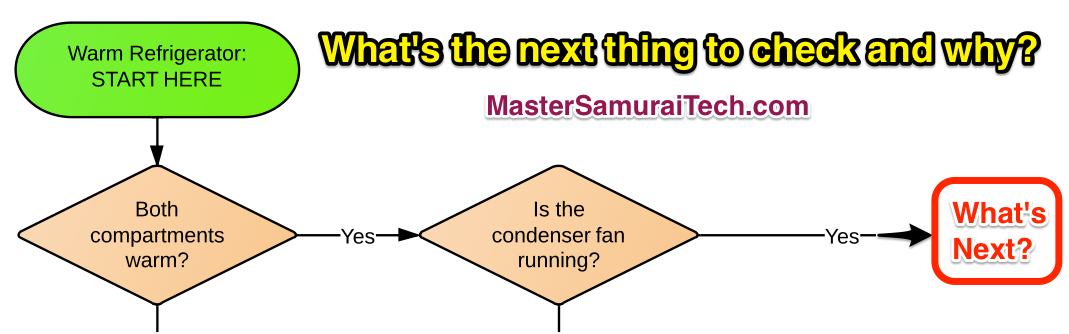

Refrigerator Flow Chart Quiz
  • 19 image comments
Check the compressor to see if it is energized, if yes: check condenser coil temperature... and pursue sealed system issue.
                                                                                 if no:  is there 120VAC to compressor circuit? check for "blown" start relay/ failed T.C.O.
