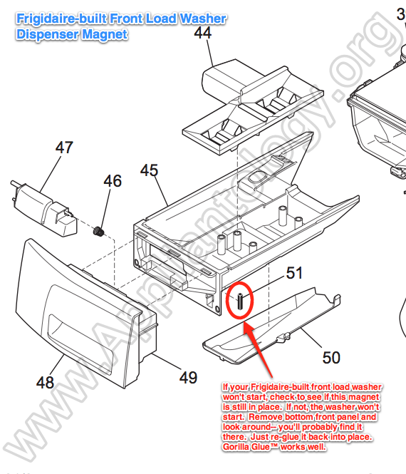

Frigidaire built Front Load Washer Dispenser Magnet

If the control board is replaced, this safety switch is no longer used. It wasn't as big of a deal as FA thought it would be. If you can't fine the magent. wire nut the two wires together. You'll see them. Two black wires leading over to the dispensor.
