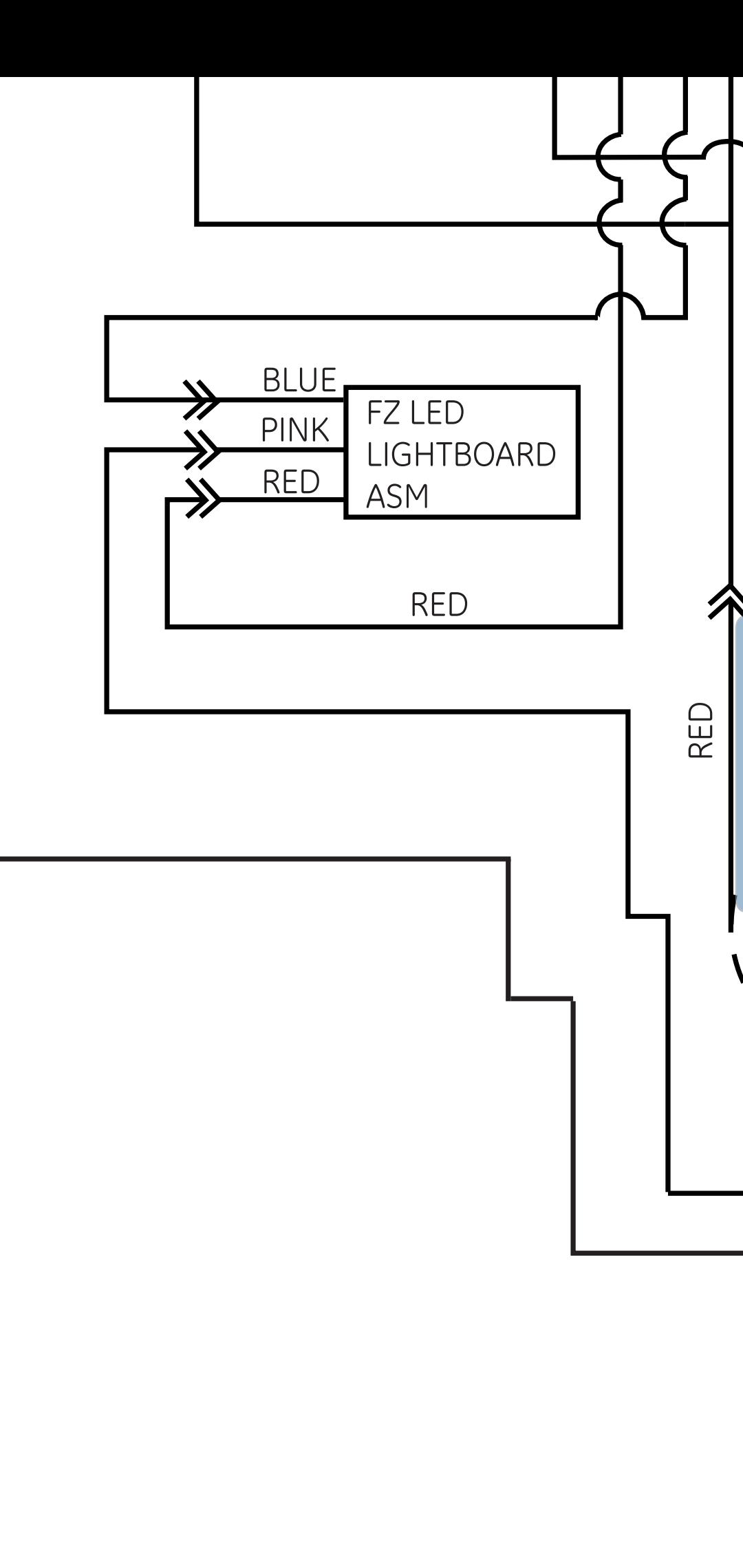

I got a call for this fridge that the display is acting up at times. Sometimes it blinks, and sometimes it just dies all together.  The client complains that the lights are blinking as well. I am wanting to look at how it is wired to determine if it is likely related. TIA!

That model uses the same mini manual as this one!
Hmmm, I don't see "lights" as loads in that diagram.
I see the Freezer LED Lightboard here.
The fridge is now not cooling properly.
