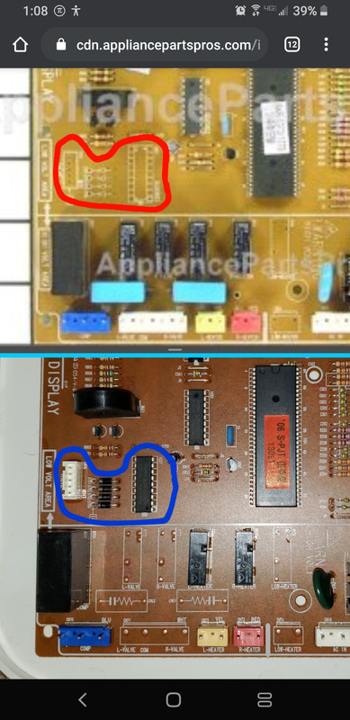

The original part number for the control board is DK41-00071A. It has been replaced with part number DK41-00063F. After reviewing both control boards, I noticed that I will not be able to plug in one of the cables with this new board. In the attached screenshot, the picture on top is the new board with the missing parts circled in red while the picture on the bottom is the original board showing the difference circled in blue.20200720-011136.jpg
The cable that plugs into the white colored port has "VALVE" written on the board:
Link to comment
Share on other sites
@WangJSoo Very easy with Samsung to get the wrong part number when looking up parts if you don't have/know the correct revision code.
Best to get the part# off the actual old board then lookup from that part number.
EDITED TO ADD:  Looks like you have already done that, (the number I see on your original board along with the date is DK41-00071A)
Do you see any other numbers on the board, (on stickers that may be similar to that format - NOT the one on top of the low voltage transformer DK26-0009C)
