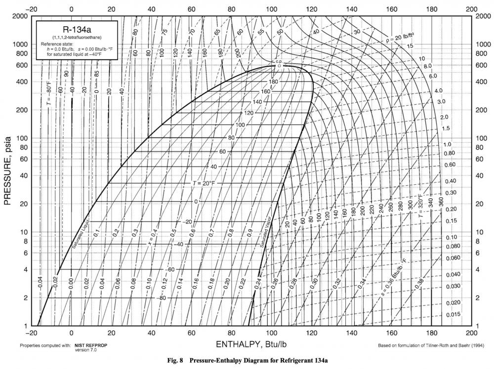

Let's step away from R-404a and look at everyone's best friend R-134a for a moment.
Thermophysical_Properties_of_Refrigerants_-_ASHRAE_Fundamentals_Ch_30_pdf__page_16_of_42_.jpg
That big dome toward the left side of the chart is fittingly called the saturation dome. That shows the pressure and temperature of the refrigerant while it's at saturation and undergoing the phase change. The left wall of the dome is the bubble point, and the right wall is the dew point.
The thing to pay special attention to is how those temperature lines within the dome are perfectly horizontal. That shows that, no matter where you are in that saturation dome, you will have a given temperature at a given pressure. Pressure and temperature directly correspond to each other no matter where you are in that phase change.
A quick sidebar about pressure -- we usually measure pressure in PSI (pounds per square inch). There are two different types of PSI, however, and either can be used. You just have to know what they mean. There's PSI Absolute (PSIA) and PSI Gauge (PSIG). The difference between them is that PSIA uses a complete vacuum as its reference. So 0 PSIA is a total vacuum. PSIG, on the other hand, uses atmospheric pressure as its reference. So 0 PSIG is the standard air pressure that we feel at sea level, which corresponds to 14.7 PSIA.
Make sense? Let's get back to the P-H diagram.
If you're paying attention, you should notice that this means there is no temperature difference between the bubble and dew points in R-134a. You can check me on this yourself -- pull up R-134a in the Ref Tools app, and you'll see that it doesn't give you the option to select Bubble or Dew.
