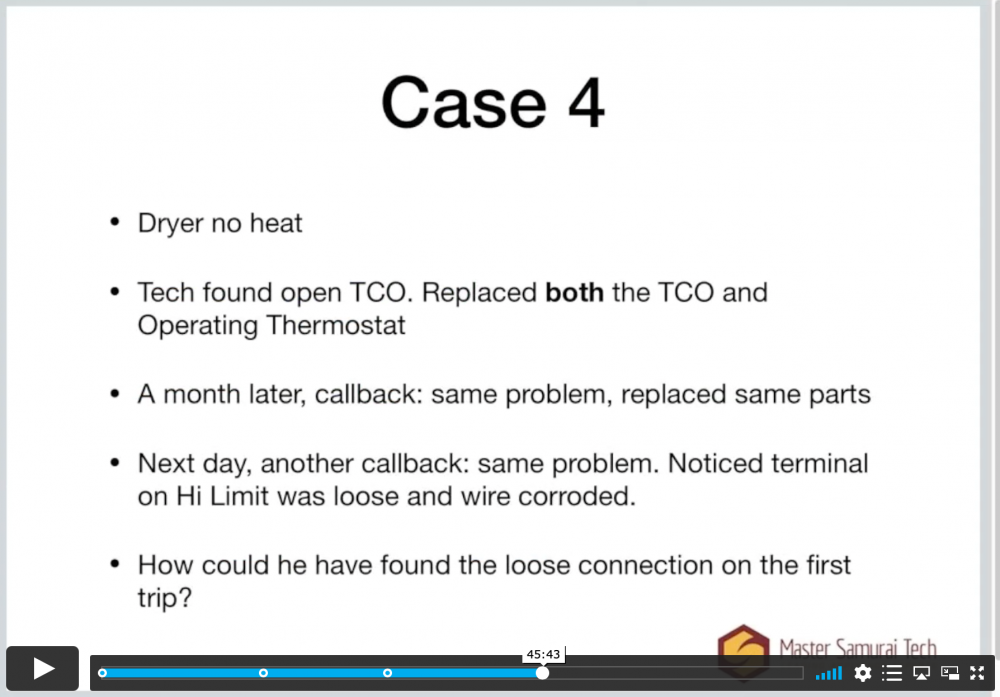

Most techs today work by the philosophy of "tear down first, use the meter later." They claim that this is "old school. I'm old school and I'm here to tell you that is absolute BS.
Let's take an all-too common, simple example: dryer keeps blowing the TCO. I can't tell you the number of techs I hear talk about disassembling the dryer, replacing the TCO, only to have it blow again soon after. And they have no idea what's going on or how to even troubleshoot this problem. As an old school tech, I try to explain that they need to get an amp reading on the heater circuit before they simply replace the TCO (in the case of an open TCO) or before they do any teardown when troubleshooting other heater circuit problems.
But most younger techs ignore this because a) they don't have the first clue how an amp reading would help solve the problem and therefore b) they dismiss this sage advice as academic BS while they fancy themselves as "old school."
For these techs to steal the "old school" moniker is an insult to us techs who truly are old school.
Check out the picture below:
This is exactly the kind of thing that would show up on an amps test of the heater circuit. THAT is old school.

Case Study 4 in this webinar recording walks through an example of using your ammeter to find out why a dryer keeps blowing the TCO. The video is tabbed so you can jump right to that case study. If you are a tech member at Appliantology, you can and should watch this webinar today:
Dryer_Case_Studies_that_will_Blow_Your_Mind_-_Professional_Appliantologist_Webinars_Forum_-_Appliantology_org_-_A_Master_Samurai_Tech_Appliance_Repair_Dojo.png

EthanRanft
I couldn’t agree more about the amp measurement. However I’m not sure how to take that measurement without disassembly first. My process would be, disassemble, replace TCO, reassemble, take amp measurement. Blown TCO=no heat=no amps
The reference here is to the complete tear down that I see most guys do when all that’s needed is to get access to the timer or control board for initial amp measurements. While technically this is disassembly, in the context of the way most guys think— complete tear down and then ohms checking each component— this qualifies “no disassembly.”
In the specific case of no amps in the heater circuit then, yes, tear down is necessary. If open TCO is found, don’t just replace the TCO. Use your jumper wire across the TCO terminals and then use your amp clamp on the jumper wire. Compare to specs. You need to do your tech due diligence to find out why that TCO blew before you just slap in a new one.
