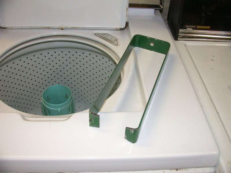

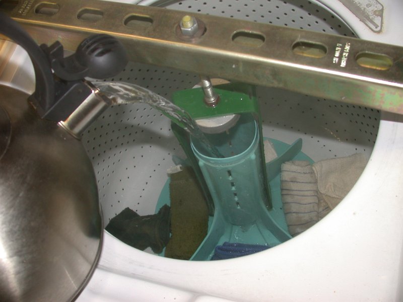

and even better, a home made agi remover thingy made using a unibar, some bent metal, a crescent wrench (or better yet, a drill driven socket)
