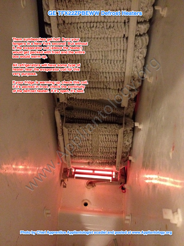

Defrost Heaters in a GE TFX22ZPBEWW Refrigerator
Photo by Chief Apprentice Appliantologist acadiel and posted at www.Appliantology.org ==> http://appliantology...gaging-defrost/
  • 19 image comments
appl.tech.29501
This particular unit has the cut out for the available upgraded heater kit WR51X442. Two heaters are always better than one ;).
