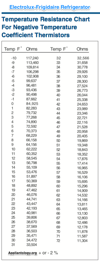

Electrolux-Frigidaire Refrigerator Thermistor Table
from PUB 5995502399 RevB 10-06-09
This is for later models with the Wave-touch and IQ-touch controls and the main PCB at the bottom.
