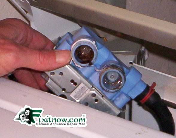

Stupid Plumber's Trick
Removing a clogged protective screen inside the water inlet is a favorite trick among plumbers... and a great way to get a house flood from the water valve sticking open. Don't do it!
