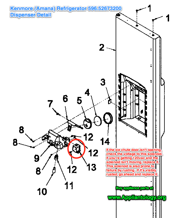

Kenmore Amana 596.52673200 refrigerator dispenser detail
