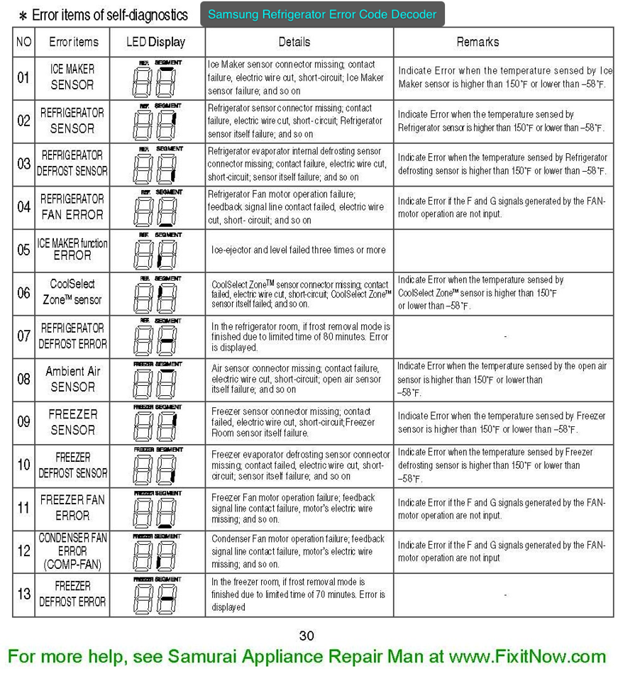

Samsung Refrigerator error Codes
This is how to decipher the LED segment error codes that you may see on the display of your Samsung refrigerator.
