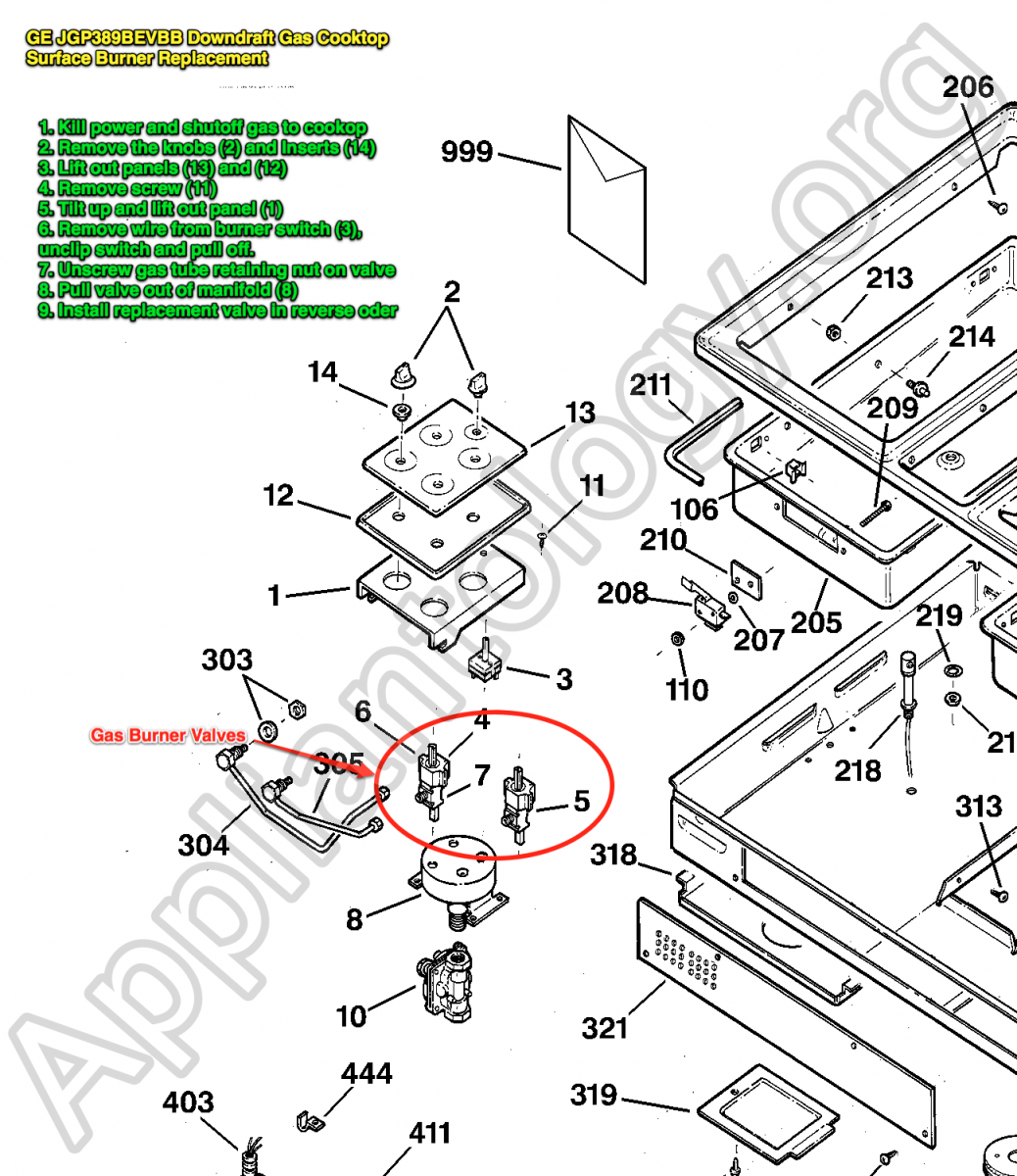

GE JGP389BEVBB Downdraft Gas Cooktop Burner Valve Replacement
If one of the knobs for a burner won't turn anymore, you need to replace the gas valve for that burner. This diagram shows how to do that. Buy the replacement gas valve here: http://www.repairclinic.com/PartDetail/Surface-Burner-Valve/WB21X5323/252638
