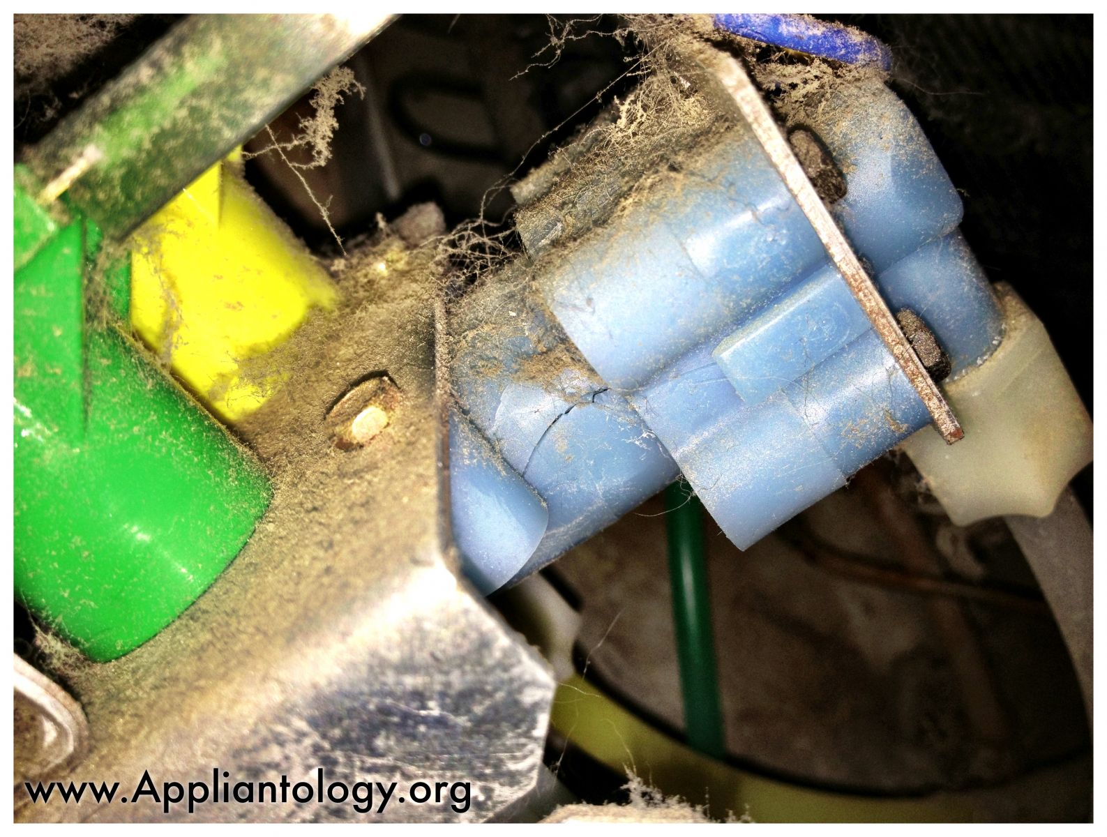

Freeze crack in a Frigidaire Refrigerator Water Inlet Valve
Common problem with homes in northern climes where the owners spend winter down south but the heat in the house it turned too low or fails.
Buy the replacement valve here: http://www.repairclinic.com/PartDetail/Water-Inlet-Valve/242253002/2689640?RCAID=24038
