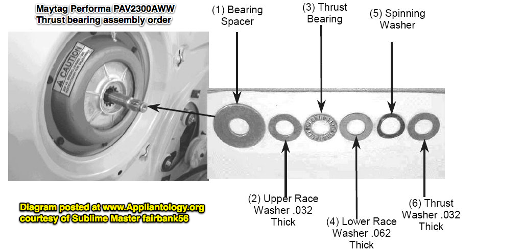

Maytag Performa PAV2300AWW thrust bearing assembly order
If you boogar up or lose these parts, you can buy the replacement kit here: http://www.repairclinic.com/PartDetail/Basket-Drive-Hub-Kit/12002213/1042142
