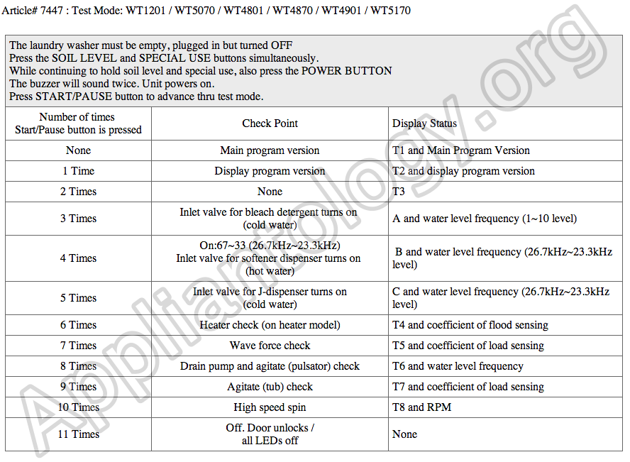

LG Top Load Washer Test Mode, Models: WT1201 / WT5070 / WT4801 / WT4870 / WT4901 / WT5170

WT4801CW was the Wash Temp and Soil Level today.
Rhubarb Tau
WT1201C is "SPECIAL USE" and "CYCLES"
Econo Appliance
Wt4801 is "custom program" and "cycles".
