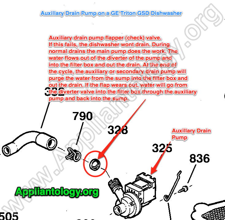

Auxillary Drain Pump On A GE Triton GSD Dishwasher
Explanation and location of flapper check valve and the auxiliary drain pump in a GE dishwasher.
