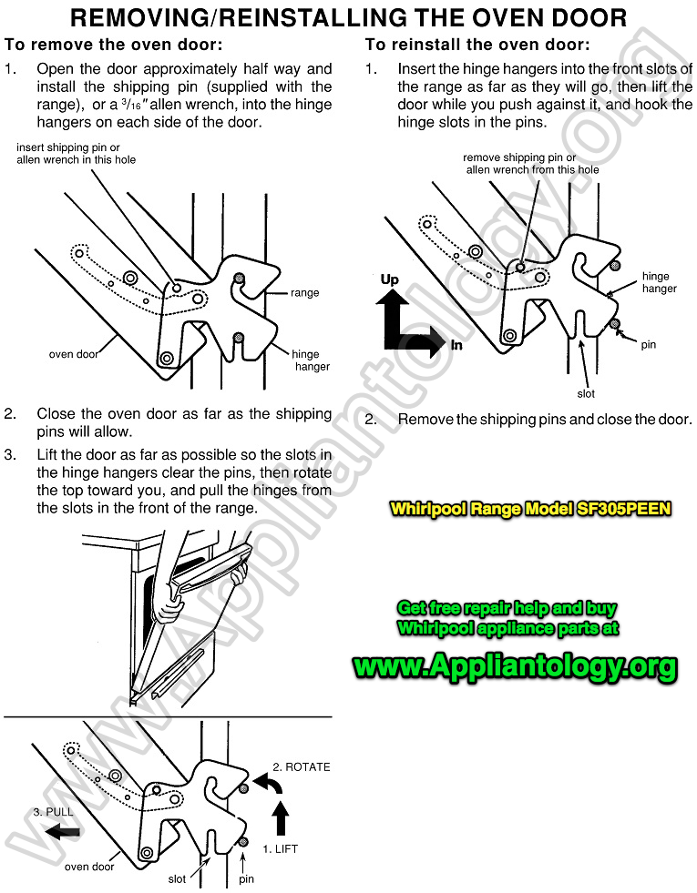

Removing the door on a Whirlpool range model SF305PEEN
Diagram showing how to remove and replace the oven door.
