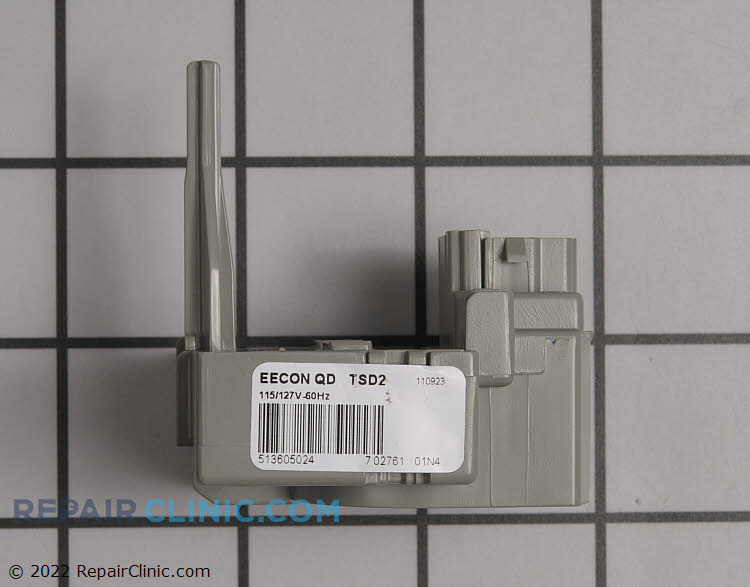

I have a Kenmore Coldspot side by side fridge 106.54683300.  It has stopped getting cold.  I cleaned the condenser which was very dirty, having not been previously cleaned 12 years.  The compressor was very warm to the touch.  When I plugged it back in the compressor would go on for about 10-15 seconds then cut out.  A few minutes later, it would repeat that cycle.  I thought perhaps it was too hot, so I unplugged it and let it cool down.  No luck.  I pulled the relay start assembly, (2255198) and replaced it with the new generation one 2319792.  Still, I am having the same issue, compressor comes on, then clicks off after about 10-15 seconds.  Compressor is cool now (hasn't been run in a few hours), same issue.  Could it be the capacitor?  Any ideas?  I don't like drinking my jack and coke with no ice. :angry:  All of the fans are working.  Thanks.

Now i'm even more confused.  I replaced the "Start-Device Combination" which is part # 2255198 on the parts diagram.  It is followed by the note "for Production Compressor Only."  It is an Embraco QD TSD2.  I am under the impression this is a start relay and overload.  The part you (DanInKansas) reference, 4387835 is on my parts diagram, with the note that it is on the "Service Commpressor Only."  There is another note on the bottom of the diagram that says "production compressor requires production electrical components, service compressor requires service electrical components."
So, I am under the impression that I either have a "start-device" which contains the relay and overload (which I have replaced) OR the separate cover / overload attached to the compressor.
I don't see any other electrical device attached to the compressor other than the one item I have replaced; with the exception of the capacitor, which attaches to the start-relay combination I have replaced.

The part you replaced does include the overload. To rule out the capacitor, you could simply try running the compressor without it. Detecting a case ground sometimes requires a super sensitive ohm meter. My multi-meter set on ohms will show a reading through my body if I grab both leads; that's not even sensitive enough. The proper tool is called a megger. Another tool you could use is a clamp on amp meter to see what the amperage draw of the compressor is. If it's drawing too much juice, the overload opens; that's its job.

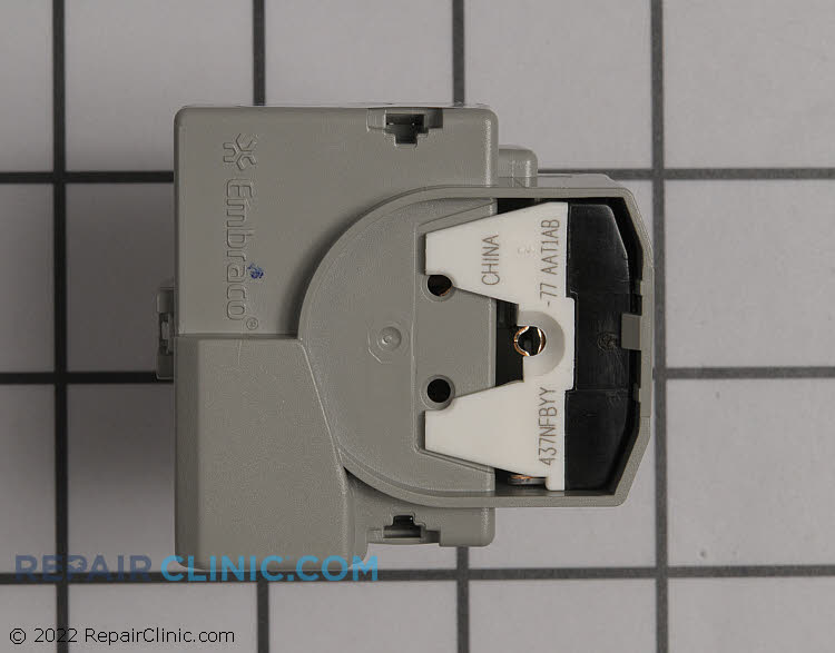

Yeah, I got on the wrong track when I saw this picture.
Looking at this picture of the same part -- the white part with the downward facing tabs  -- that's the overload. So yes Vee8Power is right.
You may want to buy another one of these anyway, just to eliminate the 1% chance it's bad out of the box, but certainly your compressor is behaving like it's not coming off the start windings and overheating the overload.
