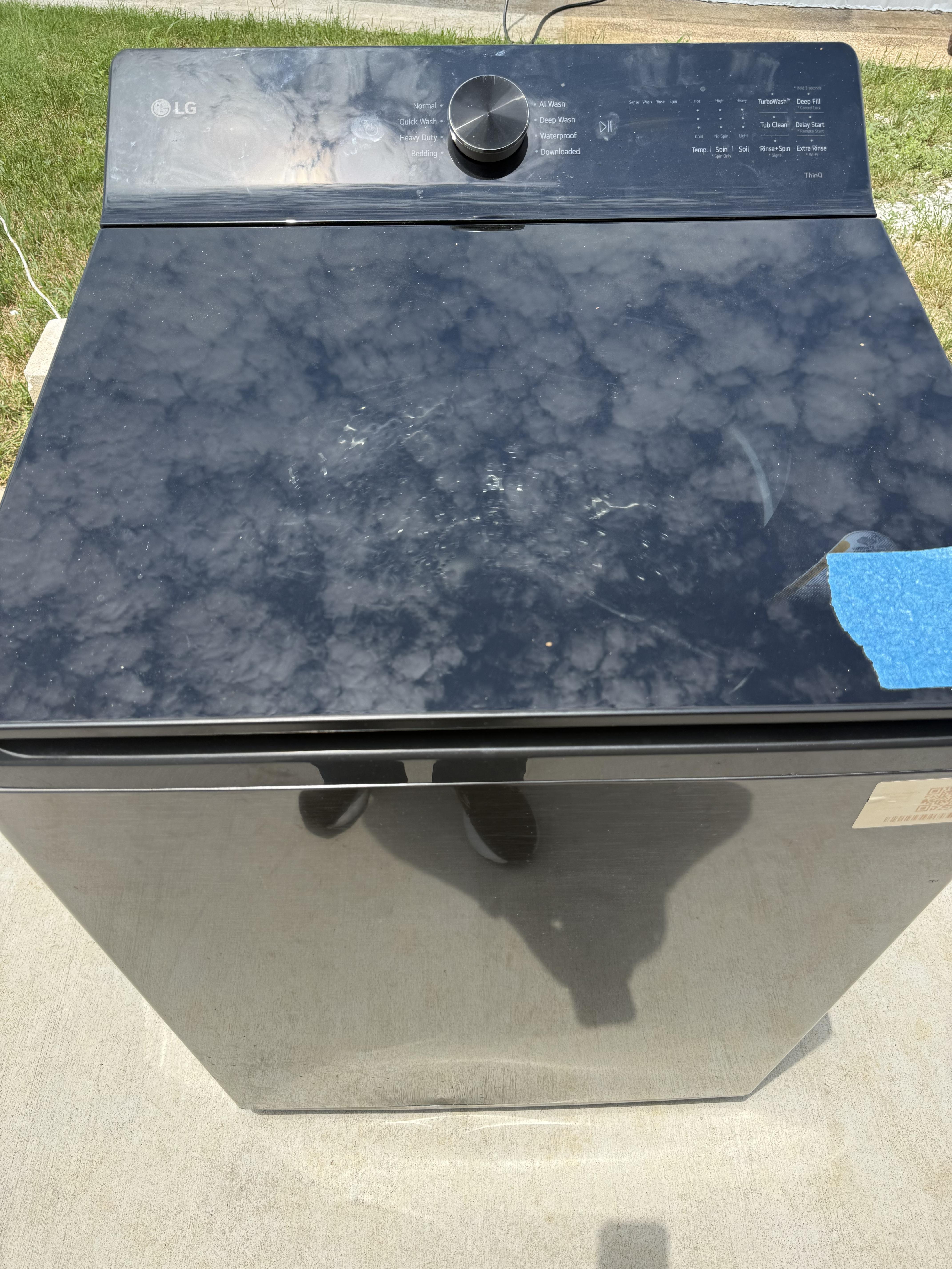

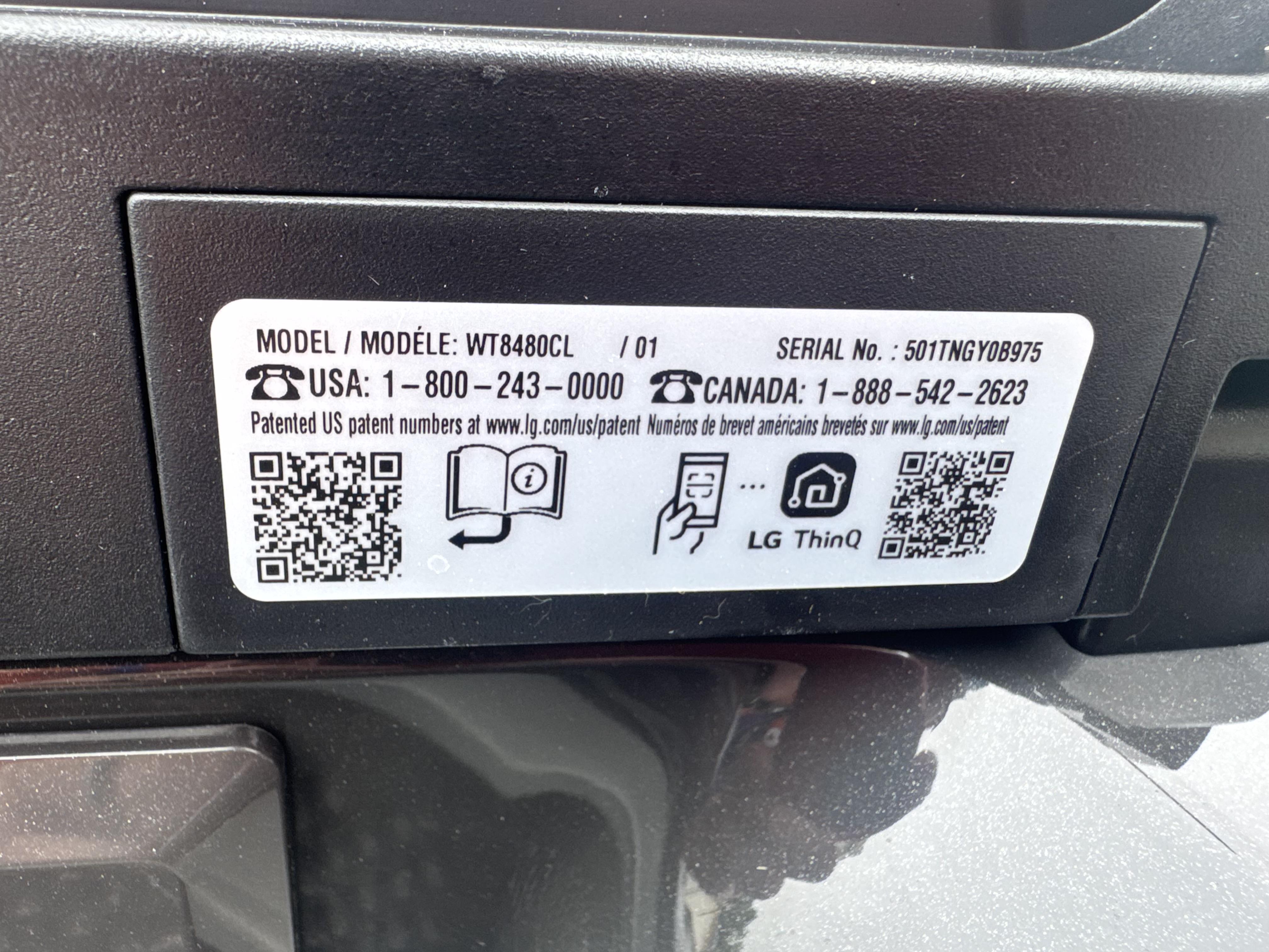

  8. Manufacturer: LG Type of Appliance: Washer Model Number: WT8480CL Have you validated the model number at an online parts site like Repair Clinic? (yes or no): Yes Have you watched the video on how to search for manuals and have you searched the Downloads section prior to posting this request? (yes or no): Yes I’m working on the new LG top load and would like to see the tech manual. thank you.
