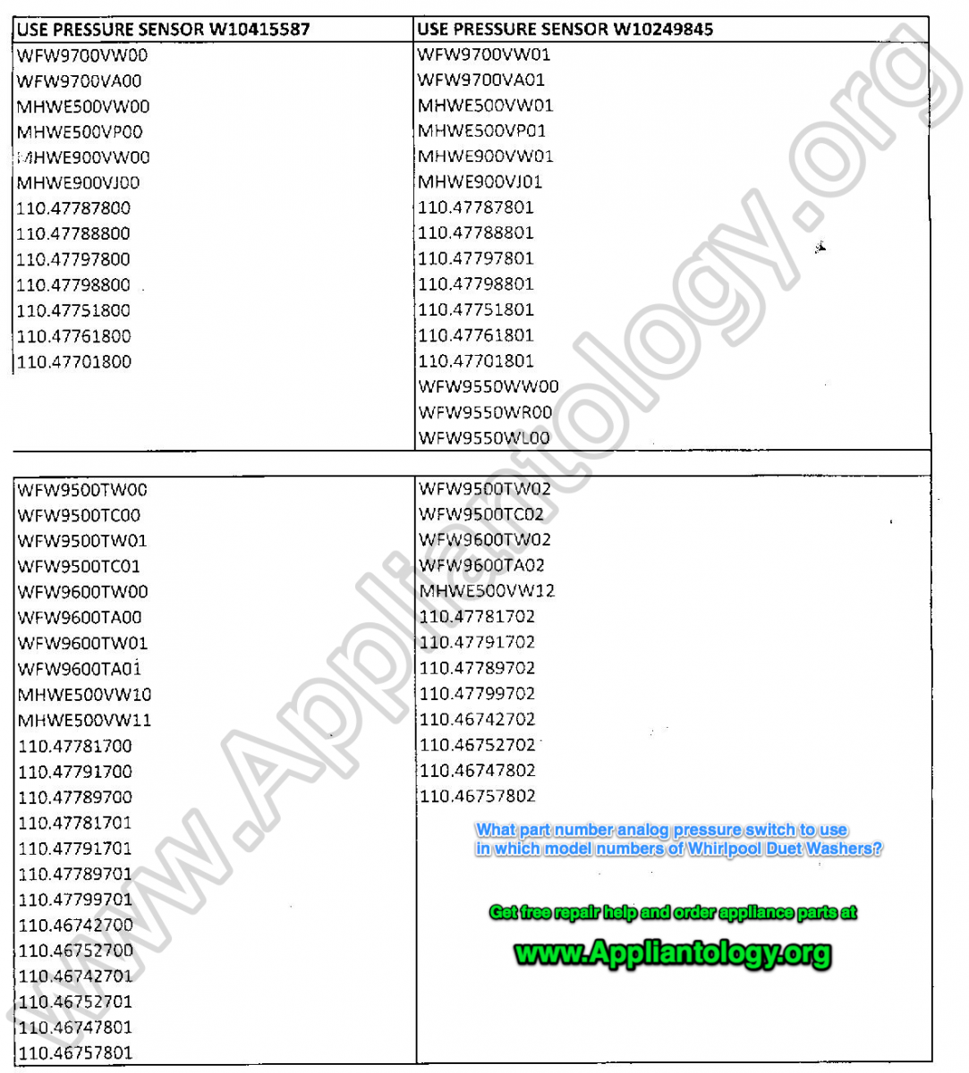

What part number analog pressure switch To Use In which model numbers Of Whirlpool Duet Washers?
Most commonly replaced for the dreaded F35 error code.
