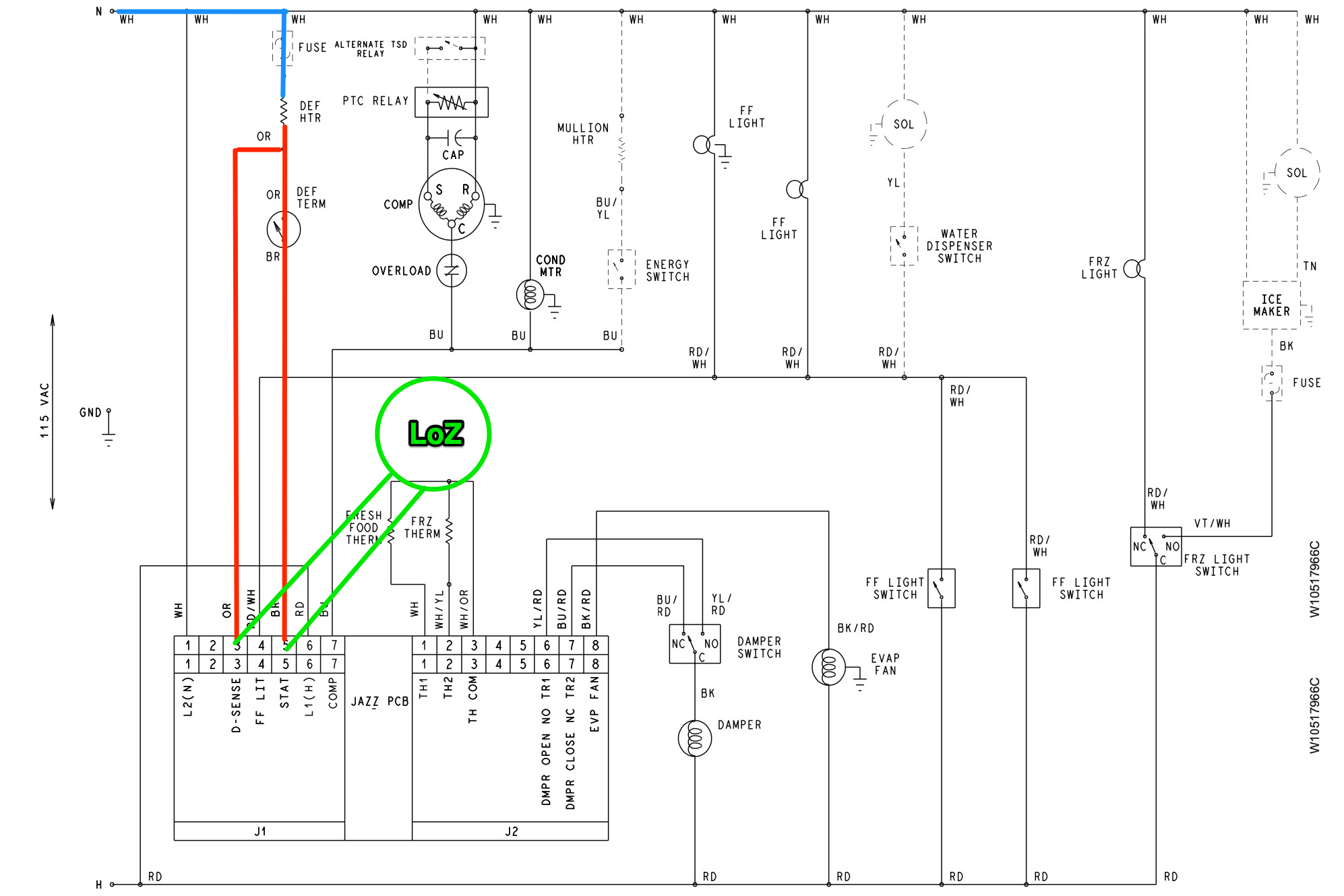

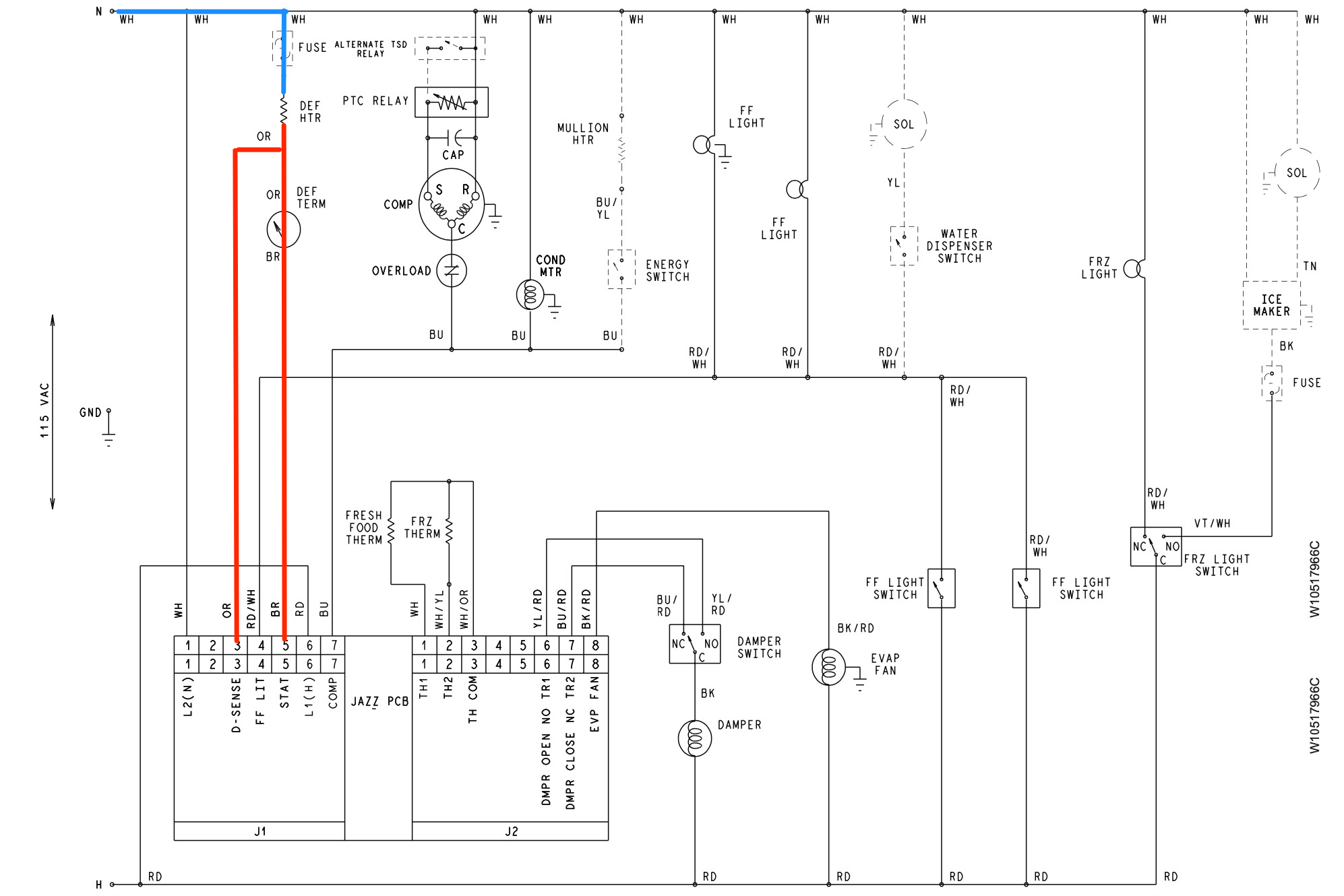

    Take a look at this evaporator fan circuit:
    Notice how the evaporator fan and the defrost heater are in series with each other? That means that, whenever amps are moving through the evaporator fan, they're also moving through the defrost heater.
    Does this mean that the defrost heater is heating any time that the evaporator fan is running?
    Obviously it doesn't -- that's just common sense. it wouldn't make any sense to design the machine like that. But then how can this circuit work as drawn?
    This isn't a mystery if you know Ohm's law. Plugging the specs of those loads into the proper Ohm's law formula, we can easily figure out that, when in series with the evaporator fan, the defrost heater produces a measly 0.3 watts.
    How much heat is that? Well, it would be about one-180th of the power output of your typical lightbulb. That is to say, an imperceptible amount of heat -- basically nothing. This is in contrast to when the defrost heater runs by itself during a defrost cycle, in which case its power output is around 440 watts.
    So, when you're troubleshooting this circuit, would you whip out your calculator in the field and actually do this math? No, probably not. But it's only by being familiar with electricity as Ohm's law describes it that you can understand this circuit.
    If you want a bonus, more complicated (and fascinating!) example of a using Ohm's law to understand a series circuit, take a look at the circled resistors and sensing points in this schematic:
    Can you tell how this dryer's heating sensing works, based on this circuit? If you want the full breakdown, click here to watch a video explaining exactly how this heat sensing works.
